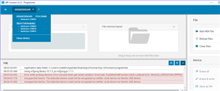

My Win 10 is up to date. Seger' J-Link driver is OK. Here's message from log screen: Please help to find what I missed. Thanks.

What version of nRFConnect and the programmer app are you using? Please check that these are up to date.
Are you able to use the DK with the SES or Keil IDEs? If not, it might be that you have deleted the Interface MCU firmware on the JLink somehow. It can be downloaded from here and dropped into the JLink driver folder on your computer.

Yes Simon,
You are right, after I uninstalled /installed latest 3.3.2 version of nRFConnect became able to connect & program nRF52 DK and integrate into latest Wireshark.
