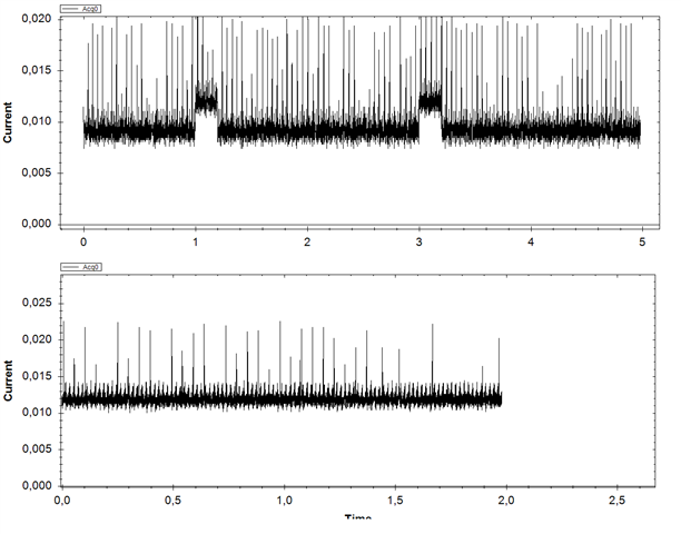

I need to measure full power consumption of nrf52, on PCA10040 from... a 5V source (because including some other 5V devices).
I measure it from 5V pin and not usb plug.
I cut SB29, to remove atmel processor leak. But I stil get around 4.5mA leakage (all led off), I don't know where from, and it seems huge for a regulator. (around 5mA +peaks while advertising)
Shoud I cut some other lines to only keep the regulator and nrf52 powered?

  • thanks. This is a new test from nordic uart exemple sdk15.3, 1st graph: advertising, 2nd graph: connected, sb29 cut, powered through 5V.
    I think it's still far higher than what I should expect, it's nearly close to an Arduino x) . On the board shematics, there is a 300ma 3.3V AP7333-33SAG-7 regulator that shouldn't use so much current. So I'm missing something, but what?
    ps: the power seems quite noisy, I don't know why, but I checked with a resistor and it's still well calibrated, no offset. It's missing some peak, as read frequency is 2ksample pr second,  which doen't seems enough to see everything.

    Indeed, these graphs look very noisy indeed. I assume the Y-axis' value is in Amperes, and if so it definitely looks very high. What application code are you running on the DK, is it one of our example projects or your own custom code? Here on my side, I have the following graph for the DK advertising regularly (ble_app_blinky).
