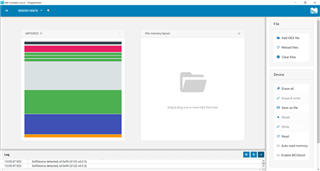

Below are the configuration setups of my firmware versions,
SDK |
SoftDevice |
FW Version 1 |
13.0 |
S 132 V 4.0.3 |
FW Version 2 |
14.2 |
S 132 V 5.0.0 |

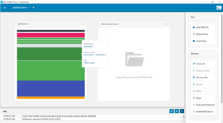

FW Version 1 Memory Map
Performed DFU to FW Version 2
I can see there is an increase of around 110 kB from 0x0005000 - 0x0006AD34 ( I could not understand what it is! )
I am very sure that memory is not because of increase in application code size.( Because I loaded hex image of Version 2 directly and confirmed this part of memory is free)
This problem has arrived only when I DFU from Version1 to Version 2.
Can you please let me know what might be the problem is and how to delete this chunk on memory.
