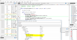

  • How do I determine the actual connection parameters? I put a break-point in on_connected() in pc-ble-driver and see many values there in the context object, but no connection-interval.
    Should i find in the embedded side with a break-point? Where?
  • I stopped at this break-point, and can see min/max conn interval are 6->7.5ms. Does that concur that the actual connection-interval is 7.5ms?

    Yes, since you are implementing the central, this will be used, and the connection interval is 6 * 1.25 ms = 7.5 ms. But as discussed earlier this is not the only thing that defines the throughput, you also need a large ATT MTU and large link-layer packets (using DLE). These are the result of negotiations.
