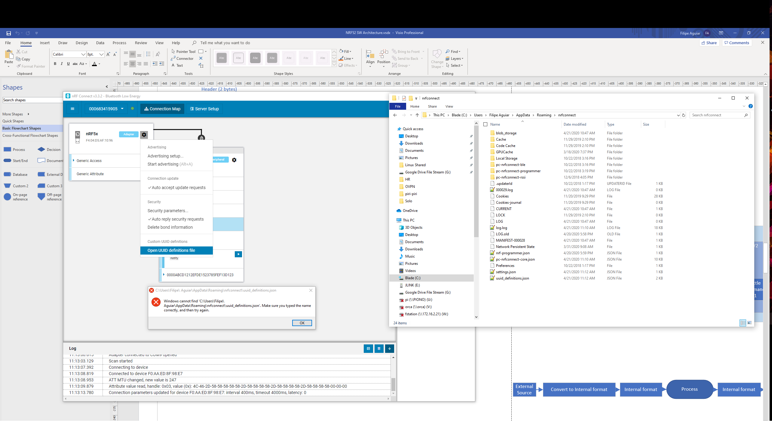

When trying to configure custom UUID the nRF Connect, the program fails to find the location of the file.
This is due my username to be "Filipe Aguiar" with a space which is split it the path  "Filipe\ Aguiar" and not "Filipe Aguiar".
