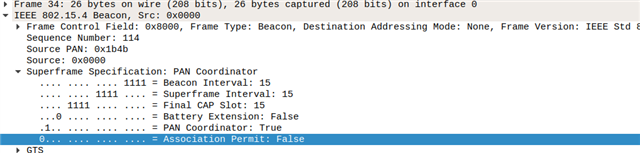

Here's my setup:
Custom board built with nRF52840
nRF5_SDK_for_Thread_and_Zigbee_v4
Segger Embedded Studio for ARM v3.52
I have built a Zigbee Coordinator and a Zigbee Router using your cli_agent_router example. I can get ONE Router to connect to the Coordinator. But that's it. When I attempt to connect a second Router, it fails in my zboss_signal_handler() at ZB_BDB_SIGNAL_DEVICE_FIRST_START

It returns "zboss_signal_handler: ZB Failed to initialize Zigbee stack - Status [-1] retry after 3 seconds". It then continues to fail in the ZB_BDB_SIGNAL_STEERING event. Note, this only happens for the second Router to attach to the Coordinator.
Attached is a Wireshark Zigbee trace of the second Router attempting to connect.
NotConnecting.pcapng
Thanks in advance for any help!
