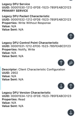

What's unclear is whether or not it's possible to push an update out to our users via our iOS app and use DFU over BLE to update the Simblee peripherals. This would be ideal as it would not require that our users send their devices back for update.
Simblee uses nRF51822 revision 3 and I think has 128K flash. See attached Simblee data sheet (block diagram on page 6).
Simblee is flashed using the Arduino IDE and a USB shield. If "#include <ota_bootloader.h>" is in app source, a bootloader capable of legacy DFU over BLE is flashed along with the application. See screen capture of nRF Connect showing legacy DFU service, etc. All 700 devices in the field have OTA bootloader flashed.
I am able to build a new version (hex file) of the Simblee app (using Arduino IDE) and use version 0.5.2 of nrfutil to create a zip file:
nrfutil dfu genpkg new_app.zip --application new_app.hex --application-version 0xffff --dev-revision 0xffff --dev-type 0xffff --sd-req 0xfffe
(Interesting that --sd-req is 0xfffe.) Using iOS-Pods-DFU-Library, I can then use the standard procedure to perform DFU over BLE. Here's the code (objective C):

Here's a log of DFU process:

2020-04-21 09:32:46.901281-0600 myapp[6798:4964585] logWith: Starting Legacy DFU...
2020-04-21 09:32:46.901292-0600 myapp[6798:4964585] logWith: Connected to p1
2020-04-21 09:32:46.901303-0600 myapp[6798:4964585] logWith: Services discovered
2020-04-21 09:32:46.901312-0600 myapp[6798:4964585] logWith: Legacy DFU Service found
2020-04-21 09:32:46.901322-0600 myapp[6798:4964585] logWith: Discovering characteristics in DFU Service...
2020-04-21 09:32:46.901332-0600 myapp[6798:4964585] logWith: peripheral.discoverCharacteristics(nil, for: 00001530-1212-EFDE-1523-785FEABCD123)
2020-04-21 09:32:47.146054-0600 myapp[6798:4964585] logWith: DFU characteristics discovered
2020-04-21 09:32:47.146596-0600 myapp[6798:4964585] logWith: Reading DFU Version number...
2020-04-21 09:32:47.146757-0600 myapp[6798:4964585] logWith: peripheral.readValue(00001534-1212-EFDE-1523-785FEABCD123)
2020-04-21 09:32:47.202713-0600 myapp[6798:4964585] logWith: Read Response received from 00001534-1212-EFDE-1523-785FEABCD123, value (0x): 0100
2020-04-21 09:32:47.202883-0600 myapp[6798:4964585] logWith: Version number read: 0.1

  • Hello Edvin,
    Thank you. Very helpful.
    Yes, I have implemented a secure DFU bootloader for our nRF52832-based product and all works well.
    I'm pretty sure the bootloader on Simblee is not secure because packages for consumption by the bootloader are generated without the use of a private key. I use version 0.5.2 of nrfutil with this command:
    nrfutil dfu genpkg simblee77-1.zip --application simblee77-1.hex --application-version 0xffff --dev-revision 0xffff --dev-type 0xffff --sd-req 0xfffe
    When I perform DFU update using nRF Connect on iOS, I get the following log:
    File Name: simblee77-1.zip
    Parts: 1

    The new package is generated using an application compiled using the Simblee library and Arduino IDE, so not sure if it uses a SoftDevice or other details. I am also able to perform DFU over BLE with our iOS app that uses the  iOS-Pods-DFU-Library with the same successful results.
    If I understand you correctly, a next helpful step would be to create my own bootloader and attempt to perform DFU to flash it to the Simblee device. It's uncertain at the moment if the bootloader on Simblee will accept a new bootloader. If that succeeds, then, given I have control over the bootloader, I can then enable it to accept S110 and a new app that uses S110. Am I understanding correctly?
    It will take me some time to create a bootloader for nRF51822. I will start with the example included with SDK 10.0. I will proceed if you feel this is the next step in the investigation.
    Again, many thanks,
    Tim
