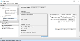

nrfgo_sdk_2.3.0_setup.exe => check "Keil uVision header files"
nrfgostudio_win-64_1.21.2_installer.msi => with nRF5x-Command-Line-Tools
Got S110 from https://www.nordicsemi.com/Software-and-tools/Software/S110/Download#infotabs
Burn it to target via nRFgo
  Succeed

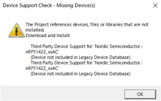

  • How can I version up to 12.3.0 ?
    Uninstalled V529, but if open the uVision .uvprjx file, V529 wakeup.
    then I went https://developer.nordicsemi.com/nRF5_SDK/nRF5_SDK_v12.x.x/
    a
    nd DL 12.3.0 then install.
    open
    \nRF5_SDK_12.3.0_d7731ad\examples\ble_peripheral\ble_app_beacon\pca10028\s130\arm4
    ble_app_beacon_pca10028_s130.uvproj
    open the V529 and message.
    impossible build. What is the correct files?
    And https://developer.nordicsemi.com/
    bottom side, witten
    nRF51822 DK, nRF51822 EK, nRF51422 DK and nRF51422 EK
    • Supported by nRF51 SDK v6.x.x and v5.x.x
    I'm conmusing..
    Sorry.
  • yujine said:
    Uninstalled V529
     What is V529?
    Do you use Keil4? Can you try to use Keil v5 and the arm5_no_packs folder?
