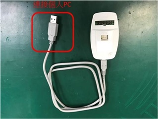

About nRF52840 SWD download
Do Nordic have SWD to USB fixture(for download FW) like below picture?
Thank you~~

Why can't you use the DK? See Debug output.
Hi
It's for our own PCB with nRF52840 development
We will connect nRF52840 SWD signal to pin header
And we need mabye 5 or more kits for RD
We use Segger J-links on our DK's and we have some SW tools that uses J-link. If you don't want to use DK's then you can use J-link Lite.
