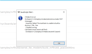

I am trying to open HTTPS client project from \v1.2.0\nrf\samples\nrf9160\https_client i am facing below error.
I tried opening different project still i am getting same error as below.

    CMake Error at D:/Katari/v1.2.0/zephyr/cmake/extensions.cmake:1457 (message):
    Assertion failed: The toolchain is unable to build a dummy C file. See
    CMakeError.log.
    D:/Katari/v1.2.0/zephyr/CMakeLists.txt:42 (assert)
    See also "D:/Katari/v1.2.0/nrf/samples/nrf9160/serial_lte_modem/build_nrf9160_pca10090ns/CMakeFiles/CMakeOutput.log".
    See also "D:/Katari/v1.2.0/nrf/samples/nrf9160/serial_lte_modem/build_nrf9160_pca10090ns/CMakeFiles/CMakeError.log".
    Project load failed
    Reported error: solution load command failed (1)
    what release of SES are you running? You should always run the latest SES version when working with NCS.
  • What options are you using when importing the project? Can you send a screenshot?
