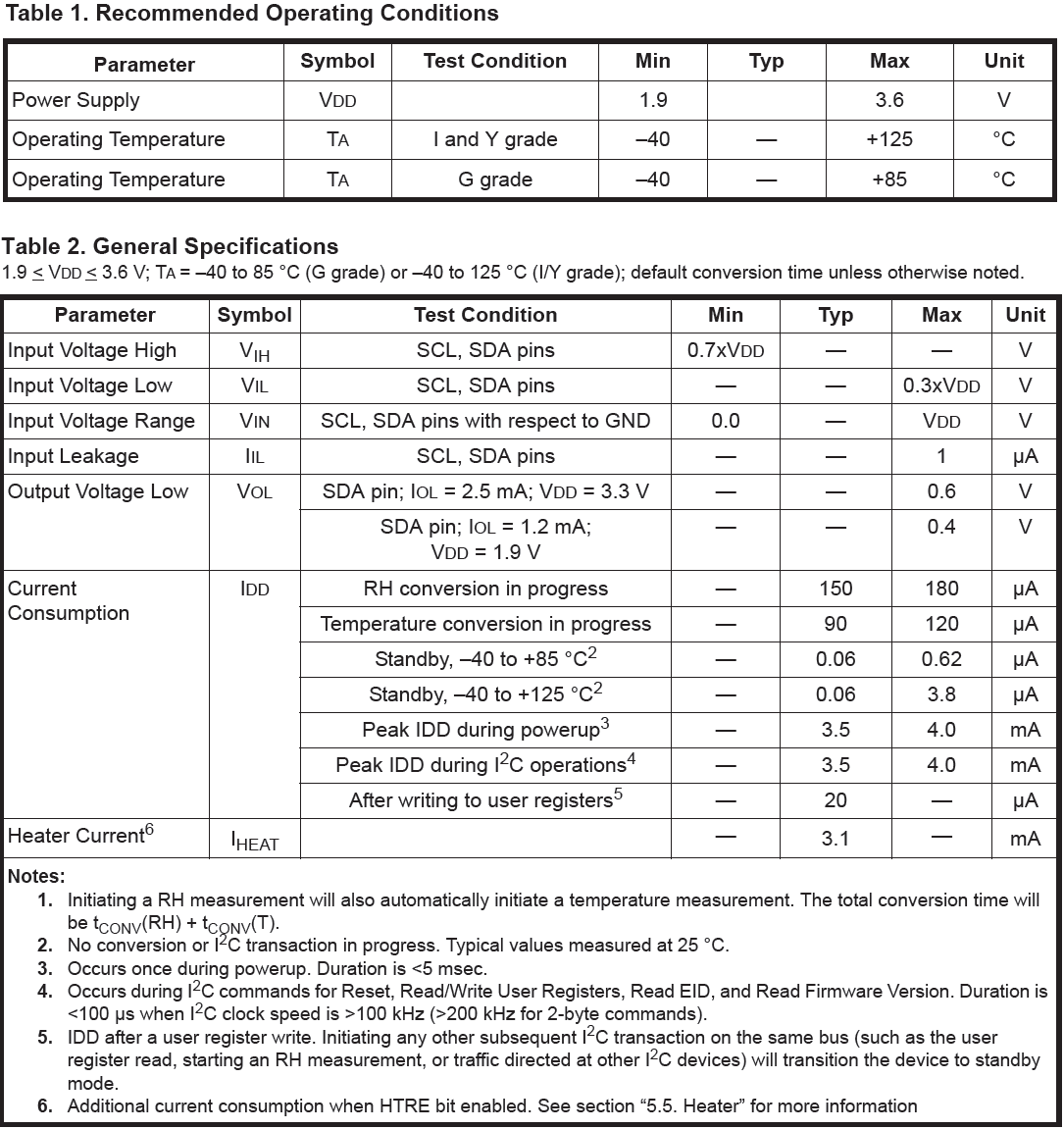

3.The temperature sensor's electrical characteristics are shown in the next picture.
current
I use 7 timers, two buttons, a white LED, and this sensor using I2C.
I'm planning to decrease the current consumption much as possible.
Although it depends how I made the PCB and the code,
could the average current consumption be less than 0.2mA in this situation?
