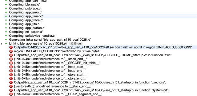

I need to develop two applications for nRF51822 using SES version 4.18 (macOS). One is a DFU bootloader. The other is an application based on the ble_app_uart (ble_peripheral) example of SDK 10.0. I will be using SoftDevice 110 and I understand that SDK 10.0 is that latest version compatible with S110.
I've been following this blog post to import a Keil project. Seems it is written for nRF52 development using an older version of SES (v3.10e) and is, therefore, inaccurate in some ways.
I would be grateful for some assistance in importing/building the ble_app_uart example from SDK 10.0 into SES.
The first step asks to install the CMSIS-CORE Support Package. In SES 4.18, it appears this package is already installed.
After importing the file nRF51SDK/examples/ble_peripheral/ble_app_uart/pca10028/s110/arm5_no_packs/ble_app_uart_s110_pca10028.uvprojx, I see a project configuration named nrf51422_xxac_s110. As I am developing for nRF51822, I wonder about additional project configuration changes needed? I understand that the nRF51422 is an nRF51822 with ANT support. I will be developing/testing with an nRF51 DK.
In the section Adding nRF5 MDK Files ...
I create embedded_studio folder inside nRF51SDK/components/toolchain.
I download ses_nrf51_startup.s and ses_nrf52_startup.s and save them into nRF51SDK/components/toolchain/embedded_studio/
When I download ses_nrf51_startup.s and ses_nrf52_startup.s, they download as 3324.ses_nrf51_startup.s and 5543.ses_nrf52_startup.s. I rename to ses_nrf51_startup.s and ses_nrf52_startup.s.
I remove Cortex_M_Startup.s from Internal Files in project explorer.
I notice that the remaining file in Internal Files is SEGGER_THUMB_Startup.s and I do not see thumb_crt0.s.
Next instructed to add NRF5_SDK/components/toolchain/system_nrf52.c to Internal Files. I assume that since I'm importing a project for nRF51, I should add system_nrf51.c instead, which I do. Same for NRF5_SDK/components/toolchain/embedded_studio/ses_nrf52_startup.s - I add ses_nrf51_startup.s instead.

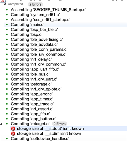

  • UPDATE: If I remove retarget.c from project, compile succeeds, but then get linker error. See attached log.

    I remember there were some issues with printf(). I found this workaround in an internal email. You can try to apply it:
    Note the thumb_crt0.s has added sections for loading on boot (one “nrf_section” to load them all), and the reference to debug_putchar is removed.
    If using printf + UART, add something like this to your project:
    int __putchar(int ch)
      return app_uart_put(ch);

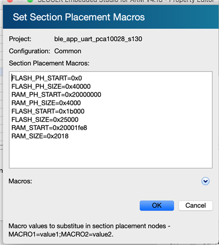

    it builds successfully. I've read that when you increase the number of ble services, you need to change RAM start and size to allow more memory for the SoftDevice. Add 16 to the RAM start address and subtract 16 from the size. I understand you do this with project -> options -> Linker -> section placement macros. Current values are:
    I tried changing RAM_START to 0x20001ff8 and RAM_SIZE to 0x2008, but still link error.

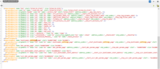

    I'm using this flash_placement.xml file:
    <!DOCTYPE Linker_Placement_File>
    <Root name="Flash Section Placement">
      <MemorySegment name="FLASH" start="$(FLASH_PH_START)" size="$(FLASH_PH_SIZE)">
        <ProgramSection load="no" name=".reserved_flash" start="$(FLASH_PH_START)" size="$(FLASH_START)-$(FLASH_PH_START)" />
        <ProgramSection alignment="0x100" load="Yes" name=".vectors" start="$(FLASH_START)" />
        <ProgramSection alignment="4" load="Yes" name=".init" />
        <ProgramSection alignment="4" load="Yes" name=".init_rodata" />
        <ProgramSection alignment="4" load="Yes" name=".text" />
        <ProgramSection alignment="4" keep="Yes" load="Yes" name=".sdh_soc_observers" inputsections="*(SORT(.sdh_soc_observers*))" address_symbol="__start_sdh_soc_observers" end_symbol="__stop_sdh_soc_observers" />
        <ProgramSection alignment="4" keep="Yes" load="Yes" name=".sdh_ble_observers" inputsections="*(SORT(.sdh_ble_observers*))" address_symbol="__start_sdh_ble_observers" end_symbol="__stop_sdh_ble_observers" />
        <ProgramSection alignment="4" keep="Yes" load="Yes" name=".pwr_mgmt_data" inputsections="*(SORT(.pwr_mgmt_data*))" address_symbol="__start_pwr_mgmt_data" end_symbol="__stop_pwr_mgmt_data" />
        <ProgramSection alignment="4" keep="Yes" load="Yes" name=".log_const_data" inputsections="*(SORT(.log_const_data*))" address_symbol="__start_log_const_data" end_symbol="__stop_log_const_data" />
        <ProgramSection alignment="4" keep="Yes" load="Yes" name=".sdh_req_observers" inputsections="*(SORT(.sdh_req_observers*))" address_symbol="__start_sdh_req_observers" end_symbol="__stop_sdh_req_observers" />
        <ProgramSection alignment="4" keep="Yes" load="Yes" name=".sdh_state_observers" inputsections="*(SORT(.sdh_state_observers*))" address_symbol="__start_sdh_state_observers" end_symbol="__stop_sdh_state_observers" />
        <ProgramSection alignment="4" keep="Yes" load="Yes" name=".sdh_stack_observers" inputsections="*(SORT(.sdh_stack_observers*))" address_symbol="__start_sdh_stack_observers" end_symbol="__stop_sdh_stack_observers" />
        <ProgramSection alignment="4" keep="Yes" load="Yes" name=".cli_command" inputsections="*(.cli_command*)" address_symbol="__start_cli_command" end_symbol="__stop_cli_command" />
        <ProgramSection alignment="4" keep="Yes" load="No" name=".nrf_sections" address_symbol="__start_nrf_sections" />
        <ProgramSection alignment="4" keep="Yes" load="Yes" name=".log_dynamic_data"  inputsections="*(SORT(.log_dynamic_data*))" runin=".log_dynamic_data_run"/>
        <ProgramSection alignment="4" keep="Yes" load="Yes" name=".fs_data"  inputsections="*(.fs_data*)" runin=".fs_data_run"/>
        <ProgramSection alignment="4" keep="Yes" load="Yes" name=".cli_sorted_cmd_ptrs"  inputsections="*(.cli_sorted_cmd_ptrs*)" runin=".cli_sorted_cmd_ptrs_run"/>
        <ProgramSection alignment="4" load="Yes" name=".dtors" />
        <ProgramSection alignment="4" load="Yes" name=".ctors" />
        <ProgramSection alignment="4" load="Yes" name=".rodata" />
        <ProgramSection alignment="4" load="Yes" name=".ARM.exidx" address_symbol="__exidx_start" end_symbol="__exidx_end" />
        <ProgramSection alignment="4" load="Yes" runin=".fast_run" name=".fast" />
        <ProgramSection alignment="4" load="Yes" runin=".data_run" name=".data" />
        <ProgramSection alignment="4" load="Yes" runin=".tdata_run" name=".tdata" />
      </MemorySegment>
      <MemorySegment name="RAM" start="$(RAM_PH_START)" size="$(RAM_PH_SIZE)">
        <ProgramSection load="no" name=".reserved_ram" start="$(RAM_PH_START)" size="$(RAM_START)-$(RAM_PH_START)" />
        <ProgramSection alignment="0x100" load="No" name=".vectors_ram" start="$(RAM_START)" address_symbol="__app_ram_start__"/>
        <ProgramSection alignment="4" keep="Yes" load="No" name=".nrf_sections_run" address_symbol="__start_nrf_sections_run" />
        <ProgramSection alignment="4" keep="Yes" load="No" name=".log_dynamic_data_run" address_symbol="__start_log_dynamic_data" end_symbol="__stop_log_dynamic_data" />
        <ProgramSection alignment="4" keep="Yes" load="No" name=".fs_data_run" address_symbol="__start_fs_data" end_symbol="__stop_fs_data" />
        <ProgramSection alignment="4" keep="Yes" load="No" name=".cli_sorted_cmd_ptrs_run" address_symbol="__start_cli_sorted_cmd_ptrs" end_symbol="__stop_cli_sorted_cmd_ptrs" />
        <ProgramSection alignment="4" keep="Yes" load="No" name=".nrf_sections_run_end" address_symbol="__end_nrf_sections_run" />
        <ProgramSection alignment="4" load="No" name=".fast_run" />
        <ProgramSection alignment="4" load="No" name=".data_run" />
        <ProgramSection alignment="4" load="No" name=".tdata_run" />
        <ProgramSection alignment="4" load="No" name=".bss" />
        <ProgramSection alignment="4" load="No" name=".tbss" />
        <ProgramSection alignment="4" load="No" name=".non_init" />
        <ProgramSection alignment="4" size="__HEAPSIZE__" load="No" name=".heap" />
        <ProgramSection alignment="8" size="__STACKSIZE__" load="No" place_from_segment_end="Yes" name=".stack"  address_symbol="__StackLimit" end_symbol="__StackTop"/>
        <ProgramSection alignment="8" size="__STACKSIZE_PROCESS__" load="No" name=".stack_process" />
      </MemorySegment>
    </Root>

  • Hi Edvin. More info. I found this post and added to flash_placement.xml:
    <ProgramSection alignment="4" load="Yes" name=".bootloaderSettings" start="$(BOOTLOADER_SETTINGS_START:0x0003FC00)" size="$(BOOTLOADER_SETTINGS_SIZE:0x400)" />
    Now get the following build log:
    Building ‘ble_app_uart_pca10028_s130’ from solution ‘ble_app_uart_pca10028_s130’ in configuration ‘Debug’
      Generating linker script ‘ble_app_uart_pca10028_s130.ld’
      Linking ble_app_uart_pca10028_s130.elf
        .bootloaderSettings is too large to fit in RAM memory segment
        section .stack_process overlaps absolute placed section .bootloaderSettings
    Build failed
    Tim
  • Try setting the bootloader settings to START: 0x3F000 and SIZE: 0x1000
