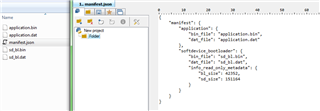

    I just tried to use nrfutil to dfu my nRF52840 EVB, below shows you what inside the package file (.zip), manifest.json and the command line to issue dfu:
    nrfutil dfu serial -pkg test.zip -p com69 -fc 0 -b 9600
    dfu can start as normal but end up the application is not being updated. Please advise how can I use nrfutil to dfu the full image (SD+BL+APP)?

  • Hi Kevin,
    Ah, now I see. You are right, I had not noticed this before, but unlike the other DFU master implementations we provide, nrfutil does not support splitting this into two operations when it acts as DFU master. Since this is not supported you will have to use two images in this case.
  • Hi Einar,
    If that is the case, serial bootloader can only support single image dfu (SD+BL) or (APP) as described in the document.
