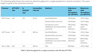

    The ble_app_uart example uses notifications to send the data from the peripheral to the central. Looking at the Bluetooth Low Energy data throughput in the S140 SoftDevice Specification, the highest achievable throughput with a single connection,  ATT MTU = 247, GAP data length = 251 and a connection interval of 50ms is 1327kbps with the 2M Phy and 702,8kbps with the 1M Phy

    I have tested the ble_app_att_mtu code and achieved 1327 kbps as referenced in the link sent.
