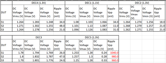

In the datasheet of 52840, we know the DEC1 is 1.1V, DEC2/4/5 are 1.3V, DECUSB is 3.3V.
When measuring these pins, we may not get a precision value, like we got the 1.08~1.101V for DEC1 / 1.262~1.268V for DEC2
Does it meet the spec. of IC when the system running?
What is the tolerance of these power pins?
If the voltage of these power pins are too high or low, how to adjust it to meet the tolerance?
