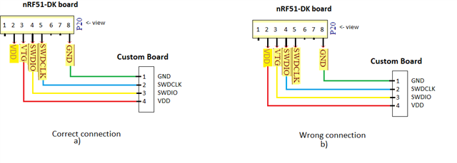

Hi all,
i have two units of a custom board project that i made.
In the first board, I plugged the pins in the right position as you can see in the figure below, a). nRFgo find the board, and i can program it normally.
However, in the second board, i wrongly connected the pins as you can see in figure b). nRFgo cant find the board even after i put the pins in the correct position. After i clicked the Recover button, it shows the message "Unable to find or open  JLinkARM.dll".
I tried to erase the dk board and the custom board but nothing worked.
I am powering both externally. My board DK version is PCA10040.
Any ideas of how can i get my board working normally again?
Thanks!
Alanarf
  • Have you tried to use nrfjprog in a command line instead of nRFgoStudio?
  • Hello ketiljo,
    thanks for the reply and sorry for my delay to answer.
    I tried nrfjprog, it returned the same message, here is the print;
    Actually any command that I type returns this message.
    Here is part of the log.log file :

    thanks,
    Alanarf
  • It looks like maybe the device is broken since you can't connect to it. Can you try  to replace the device?
  • Hi Ketiljo,
    do you mean the nrf ? because i also have an AD7147 in the board.
    I will replace the nrf chip, but do you think that just this wrong connection that i made is enough to broke the chip?
  • It depends what do you did to it then. Also make sure the power supply on your PCB is ok.
  • i just connected both DK and my custom board in the wrong way, as i put in the image of this ticket.
    I verify my power supply always, and it is on 3.3V. The power supply is ok at least.
