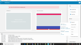

When I had tried to make this exemples works for a PCA10059 (following the instructions given here "https://devzone.nordicsemi.com/nordic/short-range-guides/b/getting-started/posts/nrf52840-dongle-programming-tutorial
" - replace BOARD_PCA10056 to BOARD_PCA10059 in preprocessor definitions), it never worked: once the device programmed (with nRF Connect), nothing happened (the dongle is not detected once plugged into a COM port (if I push on reset button it is detected but it stays in boot mode) )

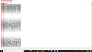

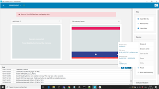

  • I also noticed that the softdevice overwrites the mbr ...
    Is it normal that the mbr is overwrited ?
  • MBR is already included in the SoftDevice, so you can remove the mbr .hex file if you use the softdevice.

    The reason it is not detected after you program it is probably because it doesn't use the USB. The main difference between the dongle and the DK is that the dongle doesn't have a programmer. It only has the USB peripheral (which would be equivalent to the USB contact on the long side of the DK, if you have seen one). So if your application doesn't actively use the USB peripheral on the nRF (which many examples does not), then it will not be detected after you program your custom application to it.
