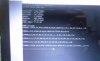

  • Hi  Oyvind,
    Am using ncs version v1.2.0
    Tested GPS example in that i can see my coordinates. Looks like having GPS coverage, But why its not sending the coordinates to the nRF cloud in asset tracker application.
