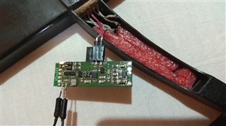

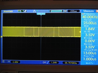

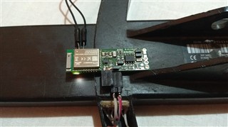

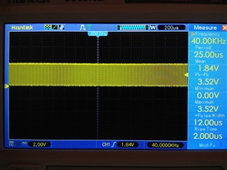

I would like to ask you for advice on how to solve my problem with Ble and the timer I have nRf52840 and I am trying to add a timer to examples\ble_peripheral\ble_app_uart timer works properly unless advertising_start(); and then the timer conflict with Ble begins. Does anyone have a solution to this problem ? I am adding part of the timer code and also photos where to see my problem.

not start advertising
start advertising
