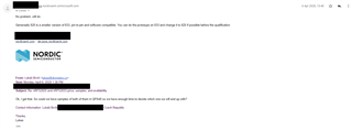

  • Bjorn, the QFN40 pin assignment was added to the nRF52833 product specification 1.2 on 27th April. We have received samples from RSM on 8th April with information that 833 and 820 are pin-to-pin compatible.
    I am not complaining but it seems that RSMs should be better informed in this manner.
    Lukas
  • Ok, was not aware that the QFN 40 pin assignments weren't added to the nRF52833 PS before April 27th.  Pin-to-pin compatibility is still correct, but in terms of software we should have mentioned that the GPIOs needs to be remapped if you want to run an application developed on the nRF52833 on the nRF52820.
    I will pass this on sales so that we communicate this more clearly in the future.
    Best regards
    Bjørn
