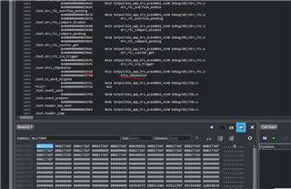

In UART console i see:
<info> app_timer: RTC: initialized.
<info> app: Before timer start
So program freezed/crashed in app_timer_start.
If i connect debugger it shows that program is running, and when i pause is shows that in paused in Handler External Interrupt(17) and has backtrace:

Why program is stuck after requesting interrupt ? How can i fix it ?
