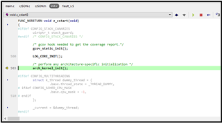

cJSON_print() issue
I'm using nRF9160DK and in that cJSON formation give me some error because of that my device will restart again and again
as in code if I'm input cJSON_AddNumberToObject(Data,"Humidity",22); that time its happening but I thing the problem with cJSON_print()
cJSON_AddItemToObject(Device_data1, "data", Data = cJSON_CreateObject());
cJSON_AddStringToObject(Data,"Temperature","67");
cJSON_AddStringToObject(Data,"Humidity","44");
//cJSON_AddNumberToObject(Data,"Humidity",22);
Attribute_json_Data = cJSON_Print(Attribute_json);

    I shared main function try to in that I just want to print that Json I tried two three way you can see in comments parts
    tried with making different function and pass there may be that will work but result is same
    cJSON_AddNumberToObject(Device_data1,"Humidity", 45);
    if I use that way to add a Number in JSON that will restart again and again my device
    but if I used String on that case its working fine as below comment code
    //    cJSON_AddStringToObject(Device_data1,"Humidity", "45");
    even if add a single json number in object that isn't working fine   ????
