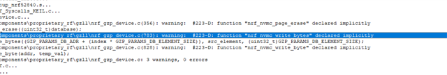

when i complete code transplantation and Compile,i find i cant download it to my pca10056 board.and it report erro    "error flash download failed -cortex-M4"

  •       with the help of Agent's engineer,now i may Position the problem,the demo of gzp_desktop_emulator  need save some infomation of
    pairing into the flash ,and the address of the flash may inside of SD size(156k), when  i   transport the code of gzp_desktop_emulator  to the
    project ble_app_gzll,i have not change the config of address, so the problem is Appeared.i cant download the app .
        i dont kown my guess is correct,if correct.may i should change this api ?
    Typically, you will get this error if there is data in the flash region that overlaps with the application you try to flash (often due to issues with application start address).
    If you have not modified the project setting, the start address should work together with the softdevice.
    You can try to erase the entire flash before retrying. We have a "erase all" option in nRF Connect Programmer app that should do the trick.
    Regarding the gzp NVMC data storage, this can be fixed by defining the symbol "SOFTDEVICE" and increasing the GZP_PARAMS_STORAGE_ADR to move this outside of the softdevice region. I would recommend a high address, in order to make space for the application as well.
