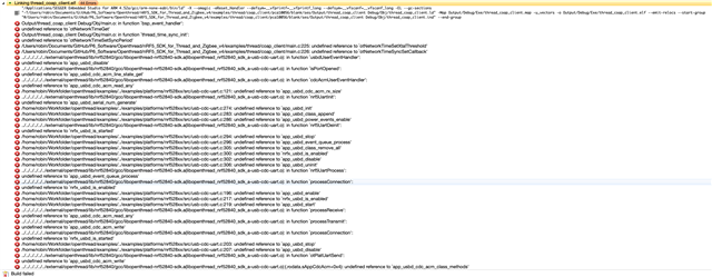

  • Hello Nordic
    I've seen that I have to rebuild the Openthread libraries to get the time_sync functions working. I got the latest Git repo from the Openthread and checked out with the commit mentioned in the SDK. I built the libs with following command:
    Fullscreen
    1
    2
    $ ./bootstrap
    $ make -f examples/Makefile-nrf52840 BORDER_AGENT=1 BORDER_ROUTER=1 COAP=1 COMMISSIONER=1 DISABLE_BUILTIN_MBEDTLS=1 DNS_CLIENT=1 DIAGNOSTIC=1 EXTERNAL_HEAP=1 JOINER=1 LINK_RAW=1 MAC_FILTER=1 MTD_NETDIAG=1 SERVICE=1 UDP_FORWARD=1 ECDSA=1 SNTP_CLIENT=1 COAPS=1 DHCP6_SERVER=1 DHCP6_CLIENT=1 USB=1 TIME_SYNC=1
    XXXXXXXXXXXXXXXXXXXXXXXXXXXXXXXXXXXXXXXXXXXXXXXXXX
    After this I followed exactly the instructions to replace the old libs like described here:
    https://infocenter.nordicsemi.com/topic/sdk_tz_v4.0.0/thread_ot_libraries_building.html
    Then I rebuilt the project in SES and got following error messages:
    Am I doing some mistakes while building the libs?
    Thank you for your support,
    Regards
    Rouben
    I do not think the example project you are building includes the libraries for USB transport. Can you try building the OT libraries without the USB=1 flag?
    Jørgen
