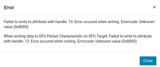

Buttonless DFU update failed
When I do a secure DFU (screen dumps pasted ), it failed with error code 0x8005. It worked on WIndows 7 PC.

  • Hi David,
    I do not have any immediate idea about what the problem is. Can you upload the full log from nRF Connect BLE? You ill find it using a button above the log output window, as shown here:
    Do you also have a log from the nRF side (using the _debug bootloader with RTT logging)?

  • Hi Einar,
    I pasted output messages from nRFConnect App:

    14:33:00.140 Performing DFU with file: /media/dzhou/Data/AssetTracking/Drill/Frc_DFU/frc_dfu_1.zip
    14:33:03.957 Attribute value changed, handle: 0x11, value (0x): 02-00
    14:33:04.156 Attribute value changed, handle: 0x10, value (0x): 01
    14:33:04.161 Attribute value changed, handle: 0x10, value (0x): 20-01-01
    14:33:09.444 Attribute value changed, handle: 0x10, value (0x): 01-00
    14:33:09.474 Attribute value changed, handle: 0x0F, value (0x): 02-00-00
    14:33:09.477 Attribute value changed, handle: 0x0F, value (0x): 60-02-01
    14:33:09.579 Attribute value changed, handle: 0x0F, value (0x): 06-01
    14:33:09.597 Attribute value changed, handle: 0x0F, value (0x): 60-06-01-00-02-00-00-00-00-00-00-00-00-00-00
    14:33:09.624 Attribute value changed, handle: 0x0F, value (0x): 01-01-8D-00-00-00
    14:33:09.626 Attribute value changed, handle: 0x0F, value (0x): 60-01-01
    14:33:11.157 Received status with code 4 Unknown value, message: 'Error sending packet to target. Code: 0x802a'
    14:33:11.191 Attribute value changed, handle: 0x0F, value (0x): 01-01-8D-00-00-00
    14:33:11.192 Attribute value changed, handle: 0x0F, value (0x): 60-01-01
    14:33:12.698 Received status with code 4 Unknown value, message: 'Error sending packet to target. Code: 0x802a'
    14:33:12.740 Attribute value changed, handle: 0x0F, value (0x): 01-01-8D-00-00-00
    14:33:12.742 Attribute value changed, handle: 0x0F, value (0x): 60-01-01
    14:33:14.248 DFU failed with error: When writing data to DFU Packet Characteristic on DFU Target: Failed to write to attribute with handle: 13: Error occured when writing. Errorcode: Unknown value (0x8005) .
    14:33:14.262 Received status with code 4 Unknown value, message: 'Error sending packet to target. Code: 0x802a'

  • Einar,
    It worked on Android Phone. I pasted log messages:

    It failed after write characteristic - 06 01 01
    I read some post on your devzone, someone mentioned it may be the Jlink driver has to go back to previous version.
    Also my nrfutil is 6.1.0 version, it needs python3..7.2. But python3.7.2 is installed on usr/local/bin
    while python3.5.2 is installed on /usr/bin.
    Just for informational purpose.
    David
  • Hi David,
    The error code 0x8005 is NRF_ERROR_SD_RPC_NO_RESPONSE, and the error code 0x802a is NRF_ERROR_SD_RPC_H5_TRANSPORT_NO_RESPONSE. We sometimes see this (and other communication issues) when using the USB-UART passthrough of the onboard Segger debugger chip. Based on experience, this is usually fixed by disabling the mass storage feature of the onboard debugger, as suggested here. You can do this using the "MSDDisable" command in JLink Commander. See this for details.
    Einar
  • Hi David,
    Einar
