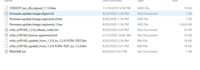

How to update modem version from 1.1.1 to 1.2.0 version by OTA. "mfw_nrf9160_update_from_1.1.1_to_1.2.0.bin" flie is missing in zip.

Hi.
Due to memory constraints, it is not possible to upgrade across minor releases of the modem firmware using DFU.
So, you can upgrade from 1.1.1 to 1.1.x, and from 1.2.0 to 1.2.y, but not from 1.1.1 to 1.2.0.
