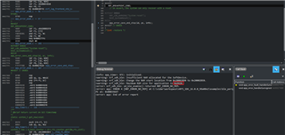

    Now sd_ble_enable () in ble_stack_init() API even before services_init() throwing NRF_ERROR_NO_MEM.

  • Another thing, I am not having UART on my board. where can I check debug log?

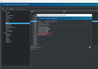

  • Hi Vidar, I changed RAM_START  from  0x20002bd0 to 0x2000ffdc as per sd_ble_enable() suggestion. But the below build error is showing up. What else can I change?
    -Lakshmi
  • Hi Lakshmi,

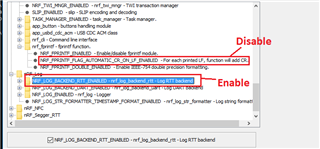

    You also need to adjust RAM_SIZE to not overflow RAM. If you use a Segger Jlink debugger you may try to enable logging over Segger RTT (uses debug interface)
    Settings in sdk_configh.h to enable logging over RTT:
    Once you have enabled RTT you should be able to view log messages in the debug terminal during debug sessions. Like this:
    And these are the RAM settings to update with the suggested values from the log:
