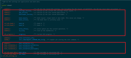

So... what is the proper way to mimic the result I saw on the DK but doing it in the main app?
    The default bootloader settings implementation does not allow the app to change the fields shown inside the red squares below. This is to help ensure that only the bootloader can do the final validation and activation of new FW images.
    But it doesn't mean that has to be done this way. I see that you are not storing any "init_command" for the bootloader, so I guess you have already done the validation and just want the bootloader to activate the FW by moving the image from Bank 1 to Bank 0? If that's the case I think it may make sense to just the change nrf_dfu_settings.c implementation to allow these fields to be controlled by the application as well. Relevant functions to modify would be settings_forbidden_parts_equal_to_backup() and settings_forbidden_parts_copy_from_backup().
    Vidar
  • Thanks for the response, Vidar.  Unfortunately I'm still not having luck.  I found this post and so I did the following:
    IN THE MAIN APP
    1. Updated my settings-writing code to look like this:
    //Update BL settings to signal a new valid app is ready
    s_dfu_settings.bank_1.bank_code                 = NRF_DFU_BANK_VALID_APP;
    s_dfu_settings.bank_0.bank_code                 = NRF_DFU_BANK_INVALID;
    s_dfu_settings.app_version                      = 0;
    s_dfu_settings.bank_1.image_crc                 = crc32_compute((uint8_t *)BANK1_FLASH_ADDR, scratchpad_data.app_len, NULL);
    s_dfu_settings.bank_1.image_size                = scratchpad_data.app_len;
    s_dfu_settings.bank_current                     = NRF_DFU_CURRENT_BANK_1;
    s_dfu_settings.bank_layout                      = NRF_DFU_BANK_LAYOUT_DUAL;
    /* Set the progress to zero and remove the last command */
    memset(&s_dfu_settings.progress, 0, sizeof(dfu_progress_t));
    memset(s_dfu_settings.init_command, 0xFF, DFU_SIGNED_COMMAND_SIZE);
    s_dfu_settings.write_offset                     = 0;
    s_dfu_settings.progress.update_start_address    = BANK1_FLASH_ADDR;
    s_dfu_settings.boot_validation_softdevice.type  = NO_VALIDATION;
    s_dfu_settings.boot_validation_app.type         = VALIDATE_CRC;
    s_dfu_settings.boot_validation_bootloader.type  = NO_VALIDATION;
    memcpy(s_dfu_settings.boot_validation_app.bytes, &s_dfu_settings.bank_1.image_crc, sizeof(uint32_t));
    s_dfu_settings.settings_version                 = NRF_DFU_SETTINGS_VERSION;
    APP_ERROR_CHECK(nrf_dfu_settings_write(NULL));
    sd_nvic_SystemReset();

    RESULTS
    1. If I put a breakpoint right before the reset in the main app I can see that the s_dfu_settings structure has changed and I get the following RTT logs, so to me that looks like the writing is happening successfully...
     nrf_dfu_settings: Writing settings...
     nrf_dfu_settings: Erasing old settings at: 0x000FF000
     nrf_dfu_flash: nrf_fstorage_erase(addr=0x0x000FF000, len=1 pages), queue usage: 0
     nrf_dfu_flash: nrf_fstorage_write(addr=0x000FF000, src=0x20024A14, len=896 bytes), queue usage: 1
    2. If I use RTT logging on the bootloader however, I see the reset happen, but I get the following print out:

    So even though it seems like a successful write is happening on the main application side, the settings don't seem to take and the bootloader doesn't recognize the new FW image.
  • UDPATE: I was able to get the update to work if I commented out the line right before the s_dfu_settings block.  This line was the piece of code that was actually doing the transferring of the code from external flash to Bank1, but since the FW image had already been transferred to Bank1 in previous calls, I could get away with commenting it out.  Obviously this won't work in production, so I'm trying to understand how this line might affect the settings writing.  The function l commented out was the external_flash_transfer_to_bank1():

  • UPDATE:  I was able to get the settings written successfully.
    I am using the SD backend for fstorage because I am using S140. From the SDK:
    [The SD] backend interfaces with the SoftDevice flash API to perform
    operations in flash. It can be used any time the SoftDevice is present,
    regardless of whether the SoftDevice is enabled or not. However, when
    running a protocol stack, the success of flash operations is tied to the
    timing constraints of the protocol and the characteristics of the hardware.
    Using too aggressive scan or advertising intervals, or running multiple
    connections, can influence the success of a flash operation.
    BUT I was only protecting the flash read/write/erases for my own internal flash transfers (by temporarily disabling the SD with nrf_sdh_disable_request()) and was re-enabling right after.  Because the sf_dfu_settings write was placed after this re-enabling, the SD was now interfering with the settings writing.  I changed my code such that I don't re-enable the SD until after all the flash functions were complete and this fixed everything.  Hope this might help someone else!
