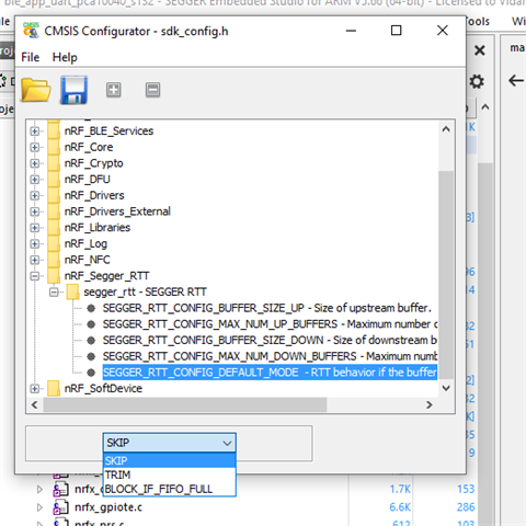

nRF52 hangs up when connected to app. With attached debugger it works perfect.
Hello i have a very strange behaviour of my custom nRF52832 board.
I use the latest SDK16 and at the moment the nRF-DK to flash and debug.
In normal (unconnected) operation everything works fine. But when i connect the device to our app it hangs up after a few seconds.
Only a hard reset will recover it.
The problem, when i attach the debugger to figure out the issue everything works just perfect. That is very strange..
Is that any errata or known problem?
I use the internal lfclock, and use the reset pin as led output.
My project based on the buttonless dfu template example.
I hope there is help for my strange issue.
