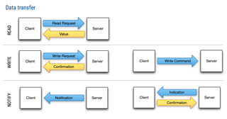

But,i confused by download.In this communication direction,maybe >4 packets/s to each slave,each packet length less than 200B. Default,in ble_nus_c_string_send, i use BLE_GATT_OP_WRITE_CMD as a param pass to sd_ble_gattc_write.There appeared serious packet loss even short distance of master and slave.
Then i try use BLE_GATT_OP_WRITE_REQ,which support reliable write.And check return of ble_nus_c_string_send_req:
if not return NRF_SUCCESS, it will try send several times(such as 100,as far as possible to reliable send).In this way,packet sent to slave is more reliable ,but the effective send rate seem is too low,maybe less than 100B/s for each slave。(PS:upload 2KB/s from slave is continuous running,when some packets download from master to slave )
Is there any way to improve it?
Make an efficient and reliable channel to send packet from master to slave.

    As long as the sd_ble_gattc_write() returns NRF_SUCESS, the packet will be delivered to the server.
    When transferring data with a write request from GATT client, then only one packet is sent every other connection event. This is because ATT level acknowledgement must be received for a sent packet before sending another packet. The procedure is as follows:
    • Connection event x: Send writeRequest packet
    • Connection event x+1: Receive ATT acknowledgement packet
    • Connection event x+2: Send writeRequest packet
    • Connection event x+3: Receive ATT acknowledgement packet
    and so on. So with connection interval 7.5ms, then one packet can be sent every 15ms, therefore substantially limiting throughput.
    But with Write Command packet you can send multiple packets each connection interval, and you will therefore get much higher throughput with Write Command.

  • The slave/server can only send data on it's own initiative using notification or indication. See this figure:
    You can read more about difference between notification and indication in this post: https://devzone.nordicsemi.com/f/nordic-q-a/99/notification-indication-difference
    This page about throughput might also be helpful for you: https://infocenter.nordicsemi.com/index.jsp?topic=%2Fsds_s132%2FSDS%2Fs1xx%2Fble_data_throughput%2Fble_data_throughput.html
