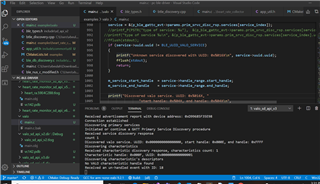

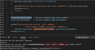

I need to scan the peripheral dongle's 128 bit UUID service and its characteristics,my code is based on heart rate collector of pc-ble-driver,before scanning I am registering the uuid with the softdevice as per the suggestions from your forum posts as below, its adding and registering but the problem is its displaying the uuid as all 0's as 0x0000000000000000 ,I am also attaching the screenshots

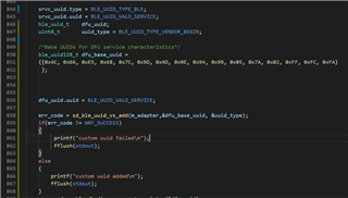

    Please check the below code
     ble_uuid_t    dfu_uuid;
        uint8_t       uuid_type = BLE_UUID_TYPE_VENDOR_BEGIN;
        /*Base UUIDs for DFU service characteristics*/
        ble_uuid128_t dfu_base_uuid =
        {{0x4C, 0x66, 0xE5, 0x68, 0x7C, 0x9D, 0x4D, 0x0E, 0x94, 0x9B, 0x05, 0x7A, 0x02, 0xFF, 0xFC, 0xFA}
        dfu_uuid.uuid = BLE_UUID_VALO_SERVICE;
        err_code = sd_ble_uuid_vs_add(m_adapter,&dfu_base_uuid, &uuid_type);
        if(err_code != NRF_SUCCESS)
             printf("custom uuid failed\n");
             fflush(stdout);
        else
            printf("custom uuid added\n");
            fflush(stdout);
         err_code = ble_db_discovery_evt_register(&dfu_uuid);
             printf("ble_db_discovery_evt_register failed\n");
             fflush(stdout);
        else
            printf("ble_db_discovery_evt_register added\n");
            fflush(stdout);
        // Initiate procedure to find the primary BLE_UUID_VALO_SERVICE.
        err_code = sd_ble_gattc_primary_services_discover(m_adapter,
                                                          m_connection_handle, 0x0E,
                                                          &dfu_uuid);
        if (err_code != NRF_SUCCESS)
            printf("Failed to initiate or continue a GATT Primary Service Discovery procedure\n");
            fflush(stdout);
        else
            printf("Initiated or continue a GATT Primary Service Discovery procedure\n");
            fflush(stdout);
    ble_db_discovery_init failed 0
    Discovering primary services
    custom uuid added
    Received an un-handled event with ID: 18
    custom uuid added
    Disconnected, reason: 0x08
  • Hi Einar, My actual question is why its printing all 0's instead of my actual 128 bit uuid of the peripheral device.I want my code to scan the actual uuids from the peripheral device  ,I have referred UART central example from nordic SDK and many examples from your forum and also followed the given procedure to scan the  advertisers corresponding services and characteristics, so I am not sure why its printing o's instead of printing the actual 128 bit UUID from the peripheral
    Yes, I believe I answered that in this post. You are printing mostly invalid memory. the 128 bit UUID does not exist anywhere you can obtain it to print it. If you want it, you have to calculate it yourself, as described in this post.
    Yes, and from what I can see you have done it correctly (after some adjustments), and it seems to work.
    That is as explained before.
