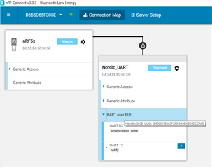

    When I connect to it in nRF Connect, it says:
    (you have to hover the mouse over the service to see the UUID when it is one of the standards in nRF Connect)
    So it translates to:
    6E400001B5A3F393E0A9E50E24DCCA9E
    While the raw UUID from ble_nus.c:
    9ECADC240EE5A9E093F3A3B50000406E
    Or:
    6E400001-B5A3-F393-E0A9-E50E24DCCA9E
    9ECADC24-0EE5-A9E0-93F3-A3B50000406E
    So it is basically reversed, but notice that one of the 0000 are replaced with 0001, which is the service UUID. You will note that the characteristic UUIDs are identical, but the 0001 are switched to 0002 and 0003 for each of the characteristics.

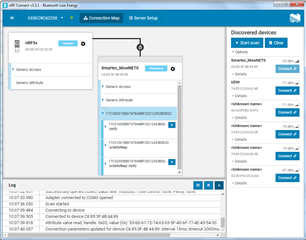

  • The product has the service UUID of 17C30001EB0747848BF33212453B0D32. It is not a heart rate monitor. I am using the heart rate collector example because it is the only example that exists in the pc-ble-driver package.
    According to the description of the struct definition, this struct "encapsulates both 16-bit and 128-bit UUIDs". For 128-bit UUIDs, I need to define the 'uuid' parameter of the struct as "octets 12-13 of 128-bit UUID", according to the description.
    It is worth noting that there is another struct type defined in this header file called "ble_uuid128_t", which only has a single parameter made up of an array of 8-bit values. However, the "sd_ble_gattc_primary_services_discover" is expecting to be passed a parameter of type "ble_uuid_t", not "ble_uuid128_t". And this function is defined in the pc-ble-driver libraries, so it's not as if I can simply modify it to take the other struct instead.
    Considering that the "ble_uuid_t" struct has a parameter for type, and this can be set to "BLE_UUID_TYPE_VENDOR_BEGIN", this seems to suggest to me that this struct should be usable for defining 128-bit UUID services. I am wondering, then, if there needs to be some other function call that sets the rest of the 128-bit UUID. If there is, though, I can't find it. The program calls "sd_ble_gattc_primary_services_discover" as its first function call on connection.
    Could you please let me know if there is either a function I need to use to set the rest of the UUID, or if there is a function I can use to pass a "ble_uuid128_t" struct instead of a "ble_uuid_t"? Thanks.
  • Here is the product when connected in nRF Connect.
