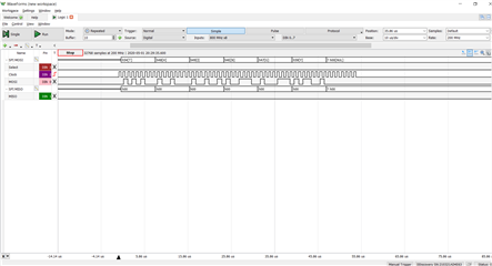

Iam trying to get the spi function to work properly on my thingy 52 device.
My problem is that the transfer wont stop when it should in my opinion, i have analyzed the MOSI and SCK (no slave connected yet) on a logic analyzer
and can see that the CLK continues for one extra byte and the data sent is hx00 or NULL. i have attached a picture of the result from the logic analyzer. The string iam trying to send is "Thingy"
This is some of the code related to the spi transfer i try to send data via spi at the end of a timer.
