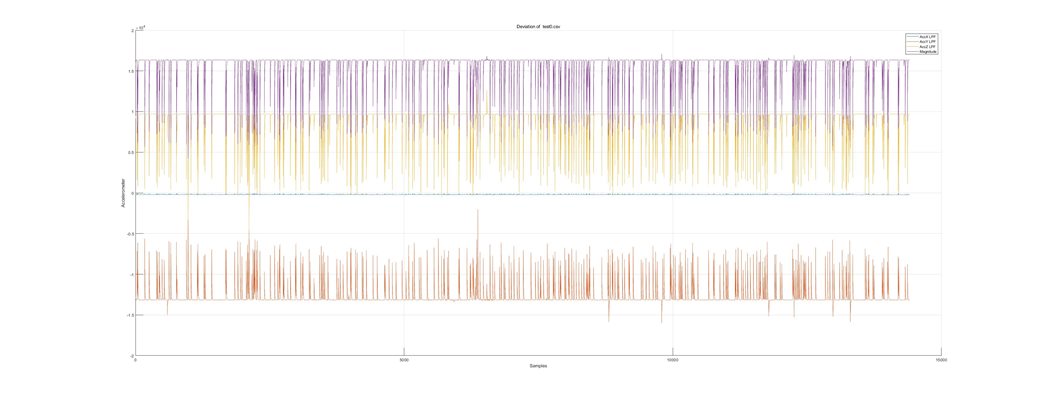

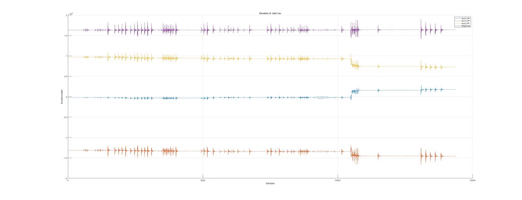

Hi. I'm developing IMU system for multiple purpose using ICM20948 & nRF52832.
But there are problems on TWI communications when using BLE simultaneously.
If not use BLE, all the data comes from IMU sensor is pretty well as shown below:
Small deviation is deliberate data for test purpose.
But after enable BLE, wrong data comes out from ICM20948 sensor as below. It is connected with TWI lines.
 Only X-Axis are normal data. I attached source codes which get or send data to ICM20948 sensor.

Please check it.
Thank you.
