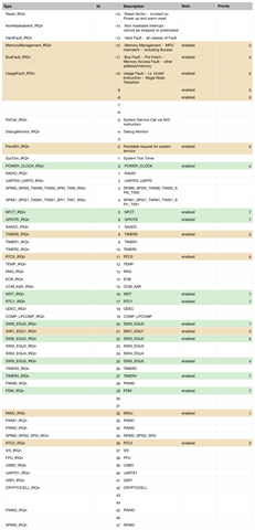

  • Another idea that I had to get a deeper insight is to check the NVIC->ISER register to see which interrupts had been enabled and what priority they were set to. The code to that describes the data format stored in the register was taken from NVIC_EnableIRQ in core_cm4.h
    for (int8_t i = Reset_IRQn; i <= SPIM3_IRQn; i++) {
      if(NVIC->ISER[(((uint32_t)(int32_t) i) >> 5UL)] & (uint32_t)(1UL << (((uint32_t)(int32_t)i) & 0x1FUL)))
        printf("Interrupt-id\t%d\tenabled\t%d\n", i, NVIC_GetPriority(i));
      } else {
        printf("Interrupt-id\t%d\n", i);
      nrf_delay_ms(1);
    From this I compiled a table based on the IRQn_Type which is defined in the nrf52840.h
    Please let me know if this type of analysis is valid and if you see it showing any hints towards the issue.
