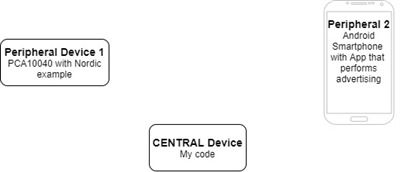

    I'm sorry if I haven't explained well the situation, please see the following image.
    I never reset my "CENTRAL Device" (nRF52) in order to disconnect the Smartphone (that works as Peripheral). In order to disconnect the smartphone I close the App or turn-off the Bluetooth interface of the phone.
     I turn-off the "Peripheral Device 1" in order to disconnect it from my "CENTRAL Device".

  • Thank you for the figure. You were right, it turned out I was confused about your central-peripheral setup.
    I have some questions:
    Assuming you are bonding the central (trying to at least) with both of the peripherals, and the issue is that the connection between peripheral 2 and central device is not stored properly.
    1: Does this happen with peripheral 1 as well if you disconnect that?
    2: Does peripheral 1 have to be connected in order for this behavior to occur? Or can we remove peripheral 1 from the equation?
    3: Have you tried with another Android or iPhone?
    4: Can you provide a sniffer trace of the connection between peripheral 2 and the central device? Both the first time they connect, and the following connection where you have to pair again? The nRF Sniffer would be sufficient. Please attach the .pcapng file from the sniffer traces here.
