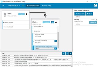

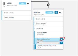

    Is there any way to exist the DFU mode by accessing GATT characteristics of DfuTarg? There "Secure DFU Packet" and "Secure DFU Control Point". May be we send some packet with reset command?
  • Yes, you can send the Abort request to trigger a reset (ie write 0xC to control point)
  • I have tried Abort to no success. The device remains in the DFU mode. See the attached picture.

  • Notifications need to be enable before you can send command requests.
    Debug logging over RTT is enabled in the debug project 'pca10056_s140_ble_debug'. The logs can be viewed with RTTViewer or RTTClient.
  • Hello Vidar,
    I have tried this but it's not working, the device does not reset by sending 0xC0 command. To demonstrate I have made a video, please have a look at that:
    drive.google.com/.../view
    Thanks.
  • It's hard to say what the problem is without being able to debug it. Have you had any success with enabling logs, and have you tried to place breakpoints inside the nrf_bootloader.c->dfu_enter_check() function?
