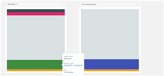

    But after that when I flash the bootloader and read the memory again by the nRF Connect Programmer the region name of the sofdevice switched to Application ( the color switches from blue to green) and the start address of the softdevice switches to be 0xFF8 instead of 0x1000.
    So I think this way when the bootloader jumps to the address 0x1000 the softdevice will not be able to run properly !

    here is a screen shot for the problem using nRF Connect Programmer.
