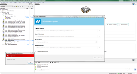

Cannot start "cmake" for nRF9160 DK GPS sample?
I am able to run all samples from this folder /ncs/v1.2.0/zephyr/samples/ and see the output on the LTE Link Monitor.
However, when I try to run the GPS sample from /ncs/v1.2.0/nrf/samples/nrf9160/gps I get a cmake error. I have attached a picture of my nRF connect options.

CMakeError:
Compiling the C compiler identification source file "CMakeCCompilerId.c" failed.
Compiler: C:/Users/esimons/ncs/v1.2.0/toolchain/opt/bin/arm-none-eabi-gcc.exe
Build flags:
Id flags:
The output was:
1
c:/users/esimons/ncs/v1.2.0/toolchain/opt/bin/../lib/gcc/arm-none-eabi/8.3.1/../../../../arm-none-eabi/bin/ld.exe: c:/users/esimons/ncs/v1.2.0/toolchain/opt/bin/../lib/gcc/arm-none-eabi/8.3.1/../../../../arm-none-eabi/lib\libc.a(lib_a-exit.o): in function `exit':
exit.c:(.text.exit+0x2c): undefined reference to `_exit'
Compiling the CXX compiler identification source file "CMakeCXXCompilerId.cpp" failed.
Build flags:
Id flags:
The output was:
1
