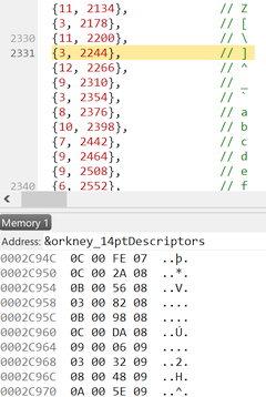

I am using the nRF GFX library to print some text on an LCD. The font, prepared with The Dot Factory v.0.1.4, is stored in flash per the examples in the sdk.

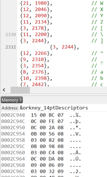

The problem is that all characters in the table after the "\" are offset by one so that the text "This is a test" appears on the LCD as "Tijt jt b uftu". As can be seen in the first attached screenshot, the table entry for the "]" is missing from the code, causing the offset. It looks like the compiler is not including that entry. In the second screenshot, adding a second entry for "]" causes an entry to be created.
In the supplied samples in the SDK, this is not a problem and I cannot see why I am getting this with identical fonts.
I'd appreciate any help.

Each entry stored as a 16bit uint.
Adding a dummy "]" creates an entry!
