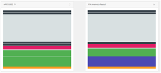

  • I just want to show something that befor DFU when I burn the bootloader file to my nrf controller  I checked the memory layout of my board it is showing the following details.
    It's showing the soft device region in hex file becomes the application region when burning to the controller. do you think this might be an issue?
    Before DFU Memory Layout
    After DFU Memory Layout becomes
    Please suggest.
    Thanks
    The DFU doesn't change the softdevice. If you read out the memory in the softdevice area, you will see that it isn't touched. It should be identical. (unless you actively update the softdevice over DFU, of course).
    It is only nRF Connect for Desktop that doesn't always understand what is placed in the specific sections.
    BR,
    Edvin
