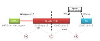

I tested a simple client-server UDP application, using as a template the UDP examples from the SDK. The UDP server is running in a nRF52 board and the client is a Python code (extracted from the Nordic infocenter) running in a Windows PC.
For my testing I have a local network with private address as shown in the picture:
This configuration was extracted from a tutorial that I found in this link:
visualgdb.com/.../
When I tested with the nordic ipv6 stack the application behaves without any problems: I can perform a ping from the Windows PC to the nRF52 board, and the UDP client (python) running in the PC Windows communicates perfectly with the nRF52 board.
But, when I use the lwIP stack:
1.- I can ping from the Windows PC to the nRF52 board without problems.
2.- When I send a packet from the PC client, the nRF52 board recive the packet, but when replaying with "udp_sendto" it returns ERR_RTE (-4) (Routing problem.)
3.- When I send the same packet, but this time with the Client running in the Raspberry Pi (using the same python code), the UDP communication work perfectly.
The problem seems to be related to a routing/subnet network address. The Windows PC is in a diferent network (fd00:b::) than the nRF52 board (fd00:a::), so the lwIP stack return the "routing problem" error. When I run the client in the Raspberry Pi it must be using the "bt0" (fd00:a::1) interface to comunicate to the nRF52 board, that is in the same network, so it work ok.
My question is, why the nordic ipv6 works ok and the lwIP have this issue? How can I address this issue in order to work with lwIP?

    I checked with our SDK team (I am not very familiar with the IoT part of the SDK, as this is actually deprecated). They said that the RTE error is a quite common error. It may mean that the address resolution process is not yet complete, and hence the lwIP stack doesn't permit to send packets on any global address yet. One thing you can try is to just wait a bit more before you send the packet, or reply to it using "udp_sendto".
    Is it possible to capture a wire shark log from the communication? Perhaps this can shed some light on the issue.
    BR,
    Edvin
  • Hi Edvin,
    Thanks for your answer.
    I made three captures, one using the firmware with the nordic ipv6 stack (that works ok, "ws_cap_nordic_ipv6.pcapng") and two with the lwIP stack ("ws_cap_lwIP_ipv6.pcapng") in the nRF52 board.
    Wireshark was running in the Raspberry Pi using the "bt0" interface for capture (I don't have the ble dongle to perform a ble capture).
    I attached the three files:
    - In the "ws_cap_nordic_ipv6.pcapng" file you can see the two UDP packets, the request from the client (PC windows) and response from the server (nRF52 board). The packets looks ok.
    - In the "ws_cap_lwIP_ipv6.pcapng" file only the UDP packet from the client is captured. The server doen't not respond because the "-4" error. Only one UDP request is present in the log.
    - In the "ws_cap_lwIP_ipv6_2.pcapng" file you can see 6 UDP packets from the client and none of them was repliyed (because the same "-4" error). Also, I wait several minutes after doing the test to be shure that the radvd performed the prefix distribution.
    By the way, I didn't know that the IoT part of the SDK was deprecated. My next step is to implement a MQTT client publisher, so , Should I try to implement it with another or external library?
    Best regards
    José Forno
    ws_cap_lwIP_ipv6.pcapngws_cap_lwIP_ipv6_2.pcapngws_cap_nordic_ipv6.pcapng
    Sorry for the late reply.
     It was never a thing that got much traction, and hence it was never completed, because of lack of interrest from customers.
    From your ipv6_2 sniffer trace, it looks like the Raspberry tries to ping the device before it has joined the network properly. Is it something special you use in the Raspberry pi image?
    You can see that it receives the ping before the nRF has received any information that it is part of a network, or has been assigned an IP address.
