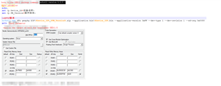

I TRY TO PROCESS OTA FROM SDK11 TO SDK13, BUT ITS NOT WORK.
WHEN I SEND THE ZIP FILES, IT WILL CLOSE OUT FROM BOOTLOADER.
SO HOW DO I PACKAGE THE ZIP FILES?
Thanks so much, but I can't find dfu_dual_bank.c in nRF libraries, where should I find it ?
Its in nRF5_SDK_11.0.0_89a8197\components\libraries\bootloader_dfu
So it means I need to update three times?
Yes, updating from the Legacy DFU to the Secure DFU will require multiple updates.
