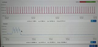

    I did try to remove all impedance matching components, but still - we get no connection to the nRF connect app on the phone. than we have only a 1 cm PCB track with a 4 cm wire - at 5 cm distance on the "working" board I get -50 dBm, so the chip itself with this poor antenna shall work.
    at the same time I measure current consumption on the board that do not advertise.
    It looks good to me.
    I use the power profiler board for the measurement.
    Similar current consumption is measured on the working board.
    so - I am really confused.
    The energy goes somewhere, but the messages are not read. Or - not read correctly.
    Unfortunately my oscilloscope is not fast enough. And I do not have a spectrum analyser.

  • Hi Plamen,
    I see from the power profiler measurements that the nRF is clearly advertising. Since you are not able to receive the advertisements we must assume there is a HW issue.
    I do not think randomly changing matching components is the way to go. Instead, since the first thing you should check is the 32 MHz crystal. Has that been changed? Which part number do you use now, and what is the value of the load capacitors?
