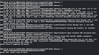

I have create a custom generic message class in iOS, to pass some data value to nordic device, in generic onoff server. Here i face problem that when i try to send the message to nordic device, it sends again again the message.

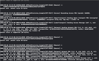

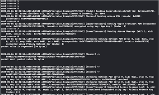

 when i use that message to  pass some data value to nordic device,  in generic onoff server. i face problem that when i try to send the message to nordic device, it sends again again the message. In console log appear as resending the message in access layer. After 3 to 4 try it get canceled with a error message. I use docklight to check receive message in nordic device  and it verify that it receive the message. i am using the nrf5 sdk 540 device to test.
message parameter contain [int8] array
