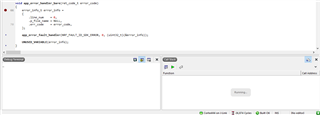

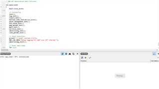

    Can you please help me with that? I just changed the main.c as following:
    1. I delete static void uart_init(void) function. Only reference is in int main(void), so I deleted it from there.
    2. I changed
     *          'new line' '\n' (hex 0x0A) or if the string has reached the maximum data length.
        static uint8_t index = 0;
        uint32_t       err_code;
        switch (p_event->evt_type)
            case APP_UART_DATA_READY:
                index++;
                    (index >= m_ble_nus_max_data_len))
                    if (index > 1)
                        do
                    index = 0;
            case APP_UART_FIFO_ERROR:
            default:
    to
    static void test(void)
        uint32_t       err_code;
        int new=1;
        switch (new)
            case 1:
                index++;
                    if (index > 1)
                        do
                    index = 0;
            default:
    3. I add "test();" function in int main(void)
    The compiling/building process works fine. But nRF connect can´t find the BLE device anymore. I also attached main.c original and main.c customized. Could you please have a look?
    Thanks in advance
    Simon

    Now, after doing this, I got a message to the debug terminal as shown in screenshot attached.
    I did the following steps:
    1. Build and debug button
    2. Go to debug terminal window (no entries)
    3. Press the play button
    I think that is not the result we would like to see. Or where can I see the errors in it?
    No, there is something odd here. First of all, I would have expected to see an error log message if an error actually occurred. And I would also have expected to see "Debug logging for UART over RTT started." printed. At least with deferred logging, that should be printed, unless the error happens earlier and prevents the log to be output. In that case, you should be able to see something useful by breaking the execution, though. I.e. you should be able to see what state the system is in, what code is being executed (where the program counter points), etc.
  • Okay...so how can we react? I think the logging and debugging is an important functionallity, we can´t dispense in the futured development. How can we solve this? Do you have any ideas?
    Depending on the error, it could cause problems with logging as outlined below. Can you upload your complete project here (which runs on a DK), and I can try to make it run with RTT logging enabled?
    I attached the project example in .zip archive. Customized files are only main.c and sdk_config.h. Thanks for analyzing!
    3757.ble_app_uart.7z
    I will start with a disclaimer: I do not have an nRF52833 DK at hand, so I modified the project slightly by using the preprocessor macros BOARD_PCA10056 and NRF52840_XXAA instead of the original in the SES project in ble_app_uart_case_249249\pca10100\s140\ses), and testing on an nRF52840 DK. It should not make any difference, though.
    There were some issues with your session file (hardcoded SDK path), so I delete that (leaving only ble_app_uart_pca10100_s140.emProject and flash_placement.xml). After that I just built and run the debug build configuration, and got the following log output:
    <info> app_timer: RTC: initialized.
    <error> app: ERROR 3735928559 [Unknown error code] at C:\Users\eith\SDK\nRF5_SDK_16.0.0_98a08e2\modules\nrfx\drivers\src\nrfx_uart.c:280
    PC at: 0x0002DF5F
    <error> app: End of error report
    This error is caused by the printf statement, which retargets to UART, which is no longer initialized in this project.  This is expected. After commenting out the printf statement the example starts to advertise.
  • It works now! After deleting the printf call, there were no other errors.
