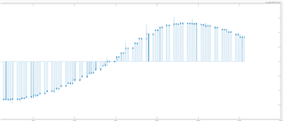

I'm using an nrf52840 dk to query another device over spi and then pipe the response back USB to a host PC. Ideally, we're piping data at 1 Mbps (which should be very much doable for USB) and for a little bit, it will work perfectly. Then randomly we'll miss 4 kB worth of packets. After plotting the data stream it's become apparent that it's quite bad. We consistently lose at least a 3rd of our packets. Furthermore, the lost data is lost in chunks. Here's an example of a 'noisy' sine wave that we sent through the serial link.
I don't believe it's an issue with the spi because I've tied an oscope to the spi pins and observed perfect spi packets being transmitted at a rate of 1 Mbps (but I could only observe maybe 20 packets at a time and didn't decode them so ...). Given that we're missing consecutive packets, and it seems to happen more or less regularly, I think this might have to do with a USB overhead issue.

EDIT: I've started saving the data to a buffer on the dev kit and reading it all out at once (ideally this decouples the SPI and USB). While I'm missing significantly fewer packets, I am still missing a few. Now I'm getting 75%-85% of all my packets. So I guess this means there is some function that's interrupting the SPI's interrupt, possibly? I've tried bumping the SPI interrupts priority but it doesn't seem to have changed anything. I'm completely out of ideas so any pointers would be a huge help.

    I send 520 bits every 500 us (so throughput is slightly higher than 1 Mbps). The software will send/receive 520 bits over SPI, then after a flag (spi_xfr_complete flag) is tripped in the main() body. After this flag is tripped, the data is processed (minorly) and then sent via USB to the host pc.
    I've built this off the CDC example so it enumerates as CDC with whatever settings were in the usb_CDC example. Does CDC have a similar limit?

    The call to app_usbd_cdc_acm_write() will not be a blocking call (ie: will return before the transaction is done), and eventually you will get a callback in your event handler with event "APP_USBD_CDC_ACM_USER_EVT_TX_DONE". At this point, the transaction is done and fully transferred to the USB host.
    It is therefore very important that you check the return code from app_usbd_cdc_acm_write(). If your timing on SPI / USB is asynchronous to each other, then you can get into a scenario where you push several packets through USB, and this function returning NRF_ERROR_BUSY (0x11, 17 decimal). At this point, you should wait, then try to call the _acm_write() function again. Its simplest form for testing purposes is: while (app_usbd_cdc_acm_write(...) != NRF_SUCCESS);

    Of course! I didn't appreciate that app_usbd_cdc_acm_write() was non-blocking and wasn't checking the return value. This is definitely a major issue that I've now fixed in my code.
    Unfortunately, that alone didn't seem to fix the issue - nor did the FIFO - nor did the combination.
    I played with my FIFO depth and in the end, putting a 2000 entry FIFO between the SPI and USB seemed to do the trick (while of course checking to make sure the usb_write() returned NRF_SUCCESS).
    Unfortunately, I worry that I haven't solved the root issue and that putting such a deep FIFO has just pushed the error further down the road.

    So at first I thought it was fixed, but ultimately no. Something is slowing down the USB transfer such that the FIFO fills up and then I start missing packets.
    Do you think these missed packets are related to how often I run _queue_process()?
    Also what did you mean by "retry function". I interpreted as checking the usb_write() return code. So now, my code will try to such that whenever a USB transfer returns something NOT(NRF_SUCCESS) then I run _queue_process() instead and then wait till the next iteration of my main loop before trying another USB transfer.
    This way my USB_transfer doesn't block me from pushing SPI data into my FIFO.
    Regardless ... I still can't empty out my FIFO fast enough.

    It could be, but without seeing the whole picture, I would only be guessing.
    Since you're using the queue, events and handling related to usbd is performed in iterations, as per how often the _queue_process() function is called. If there's something blocking the function from executing (like a delay in your main loop or similar), handling of the USBD traffic would also be delayed.
    Could you share more of your code so I can have a look, or even better; be able to reproduce the problem?
    Do you have a log file or similar which has timestamped data on the host side, to see which transfers are missing? Is the data missing, as in you see "skipped packets", or is the data delayed?
