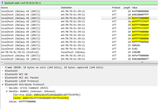

    And when analyzed with wireshark, the following results were obtained.
    1) The screenshot above is when controlling the LED of the robot.
    And the following UUID is used.
    -service UUID : 8903136C-5F13-4548-A885-C58779136701
    -UUID :              8903136C-5F13-4548-A885-C58779136703

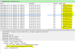

    2) The screenshot above is when controlling the Motor of the robot.
    -UUID :              8903136C-5F13-4548-A885-C58779136702
    (If I try to control the motor and use the UUID required for LED control, I cannot control the motor.)
