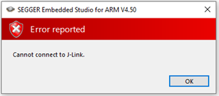

    ahh, now I have voltage level at 1,8V on nrf52833 DK. I not realized that I had to use the nRF USB Input. I used always the standard USB connection. But now, when I use nRF USB, I can´t connect/programming by J-Link. Can you tell me what to do making this work?
    Thanks in advance.
