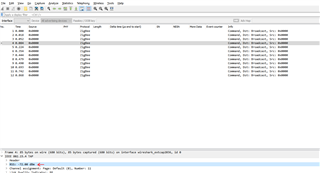

    Can you try to use the nRF Sniffer for 802154 to measure the Received Signal Strength (RSS) on the device? Does it change if you keep the devices at the same distance, but increase the output power?
    I'm not nRF Sniffer for 802154, but I got the RSSI using nrf_802154_rssi_last_get (). I changed the tx power while keeping the devices at the same distance, but the RSSI did not change.
